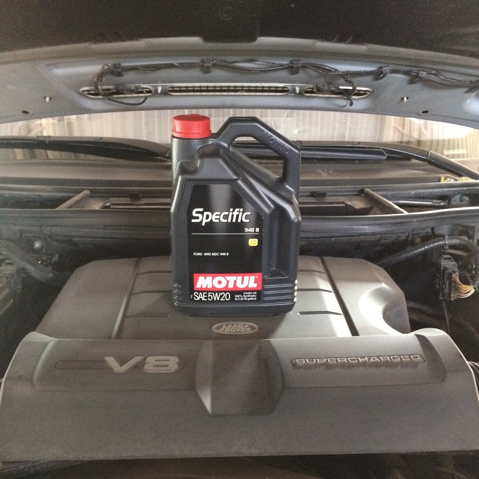

Motul: 8100 Eco-nergy 5W30
Amalie Elixir Full Synthetic — 5W-30
XENUM XPG 5W30
PETRO-CANADA EUROPE SYNTHETIC 5W-40
Motul 5W20
